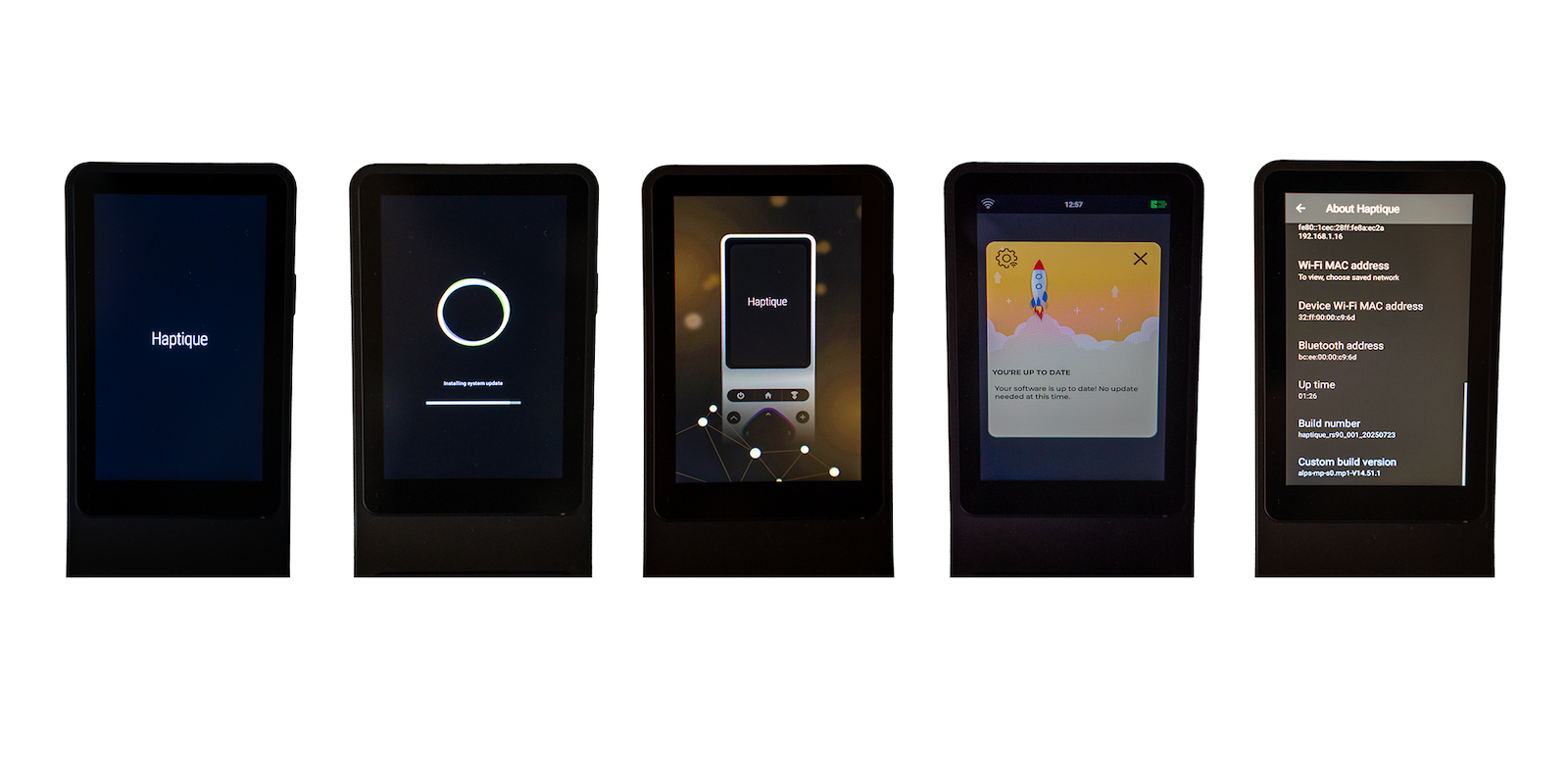

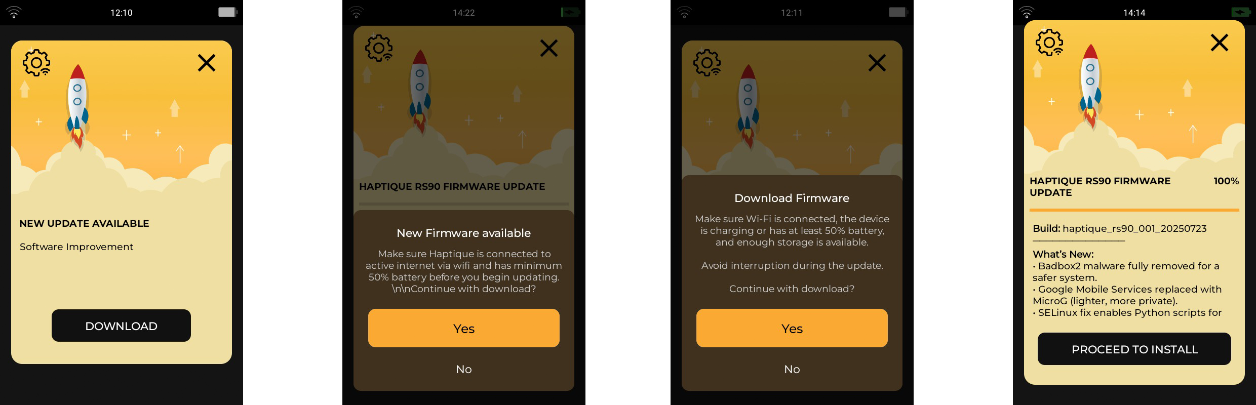

Update Process (OTA)
  1. When a pop-up appears on your controller, tap Update to begin the download.
  2. Wait for the download to finish. Keep your device powered and connected to Wi-Fi.
  3. Follow the on-screen instructions to install the firmware.
Typical duration: Installation takes about 5–7 minutes. Your device will reboot and return to the Haptique UI.
After the upgrade, your controller may appear as a new device. If needed, reconnect it with the configuration app.
