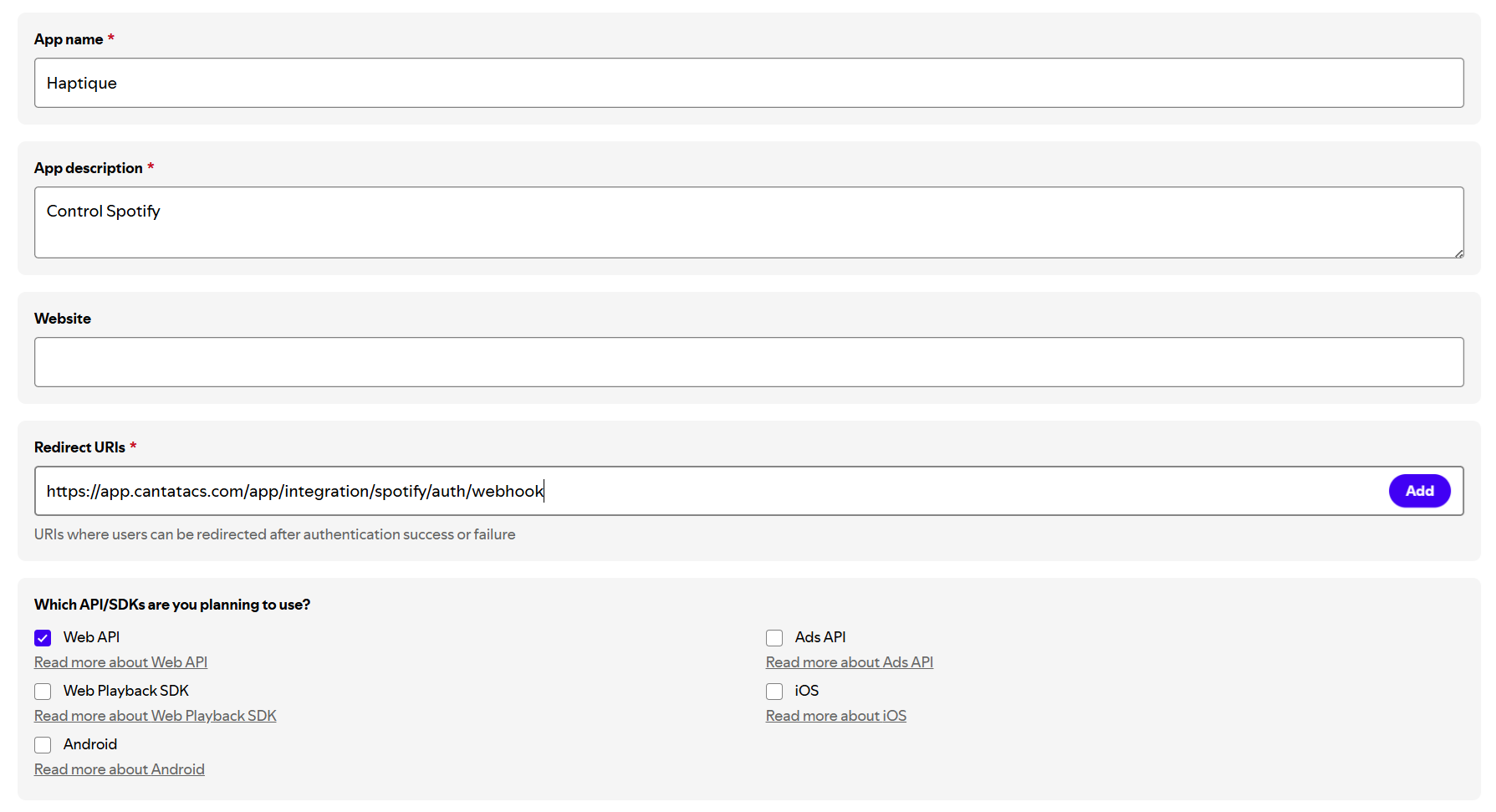

  1. Log in to the Spotify Developer Dashboard.
  2. Click Create an App (top right corner).
  3. Enter any App Name and Description (can be anything).
  4. Set the Redirect URI to:   https://app.cantatacs.com/app/integration/spotify/auth/webhook  (Important: Copy this exactly. Do not modify it.)
  5. Select Web API access.
  6. Agree to the Developer Terms and click Save.

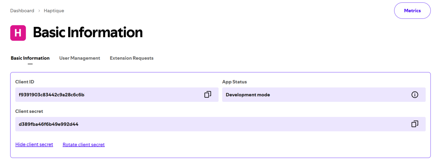

  7. After the app is created:
  8. You will be auto-directed to the Basic Information tab.
  9. Click the View Client Secret button to reveal your secret key.
You now have your:
  • Client ID
  • Client Secret
Use these two values inside the Haptique Config App to complete the Spotify integration.
